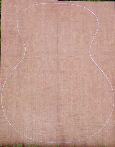

Steve, I'll be going 16" wide. This is another body style that I enjoy. 9 1/
4" waist on this guy. Steeper shoulders.   Visually, this is my favorite.
PostPosted: Sat Sep 23, 2006 9:55 am
Posts: 4817
How about a picture!
